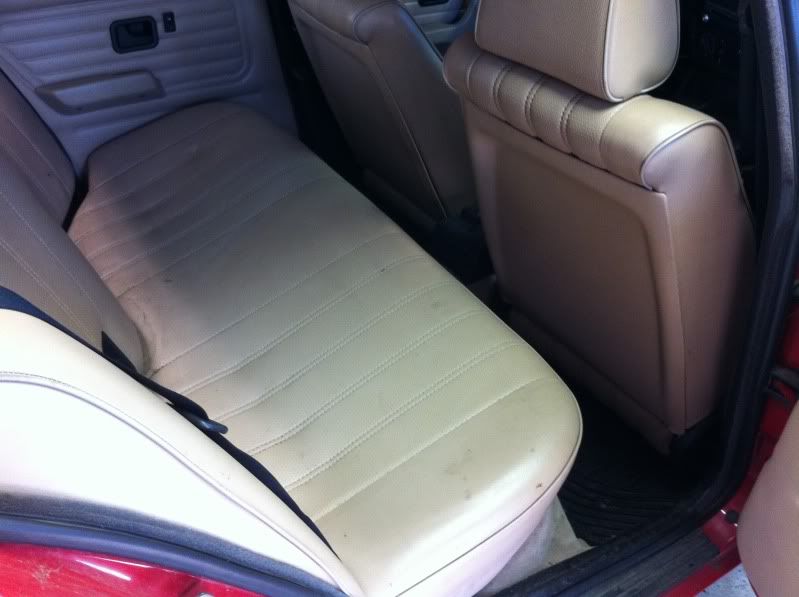

open your doors so you can get to the back seat.

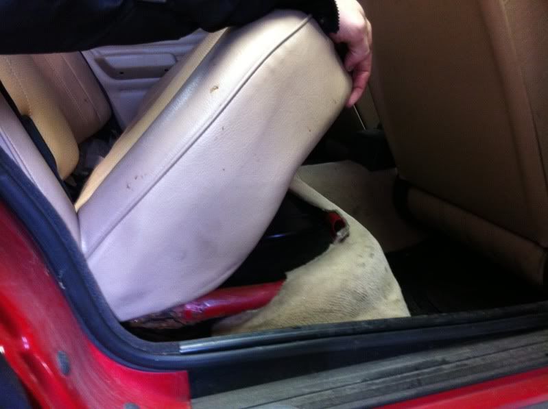

lift up hard under the front side of the back seat bottom, it will come free.
once the seat is up, youll need to move the carpet and sound deadening to access the panel. once you have access, take your phillips and un do these four screws and remove the panel

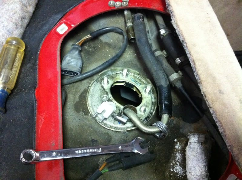

next, un do the four 8mm nuts on the level sender
once the sender is removed, you'll have something to this effect:

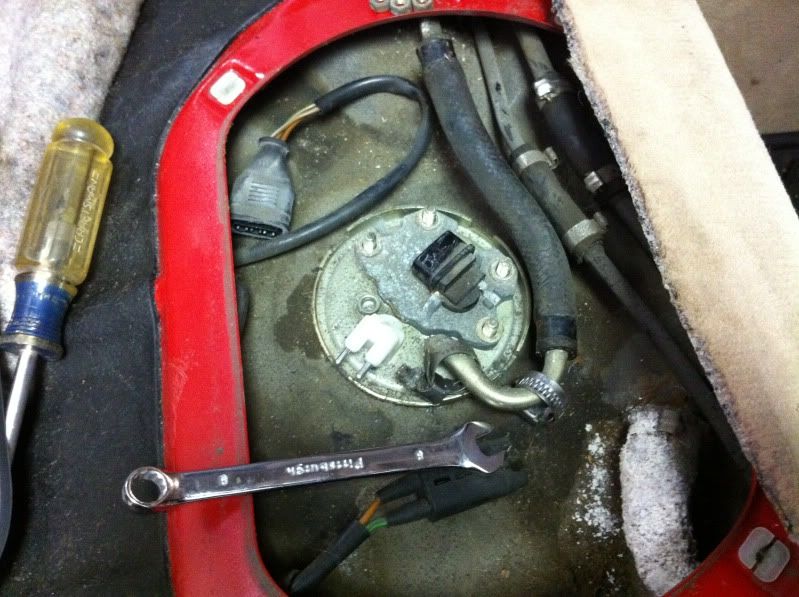

take your screw driver and get it in a position where you can rotate it counter-clockwise.
once in position, rotate it about 70 degrees counter clockwise and you'll have something like this.

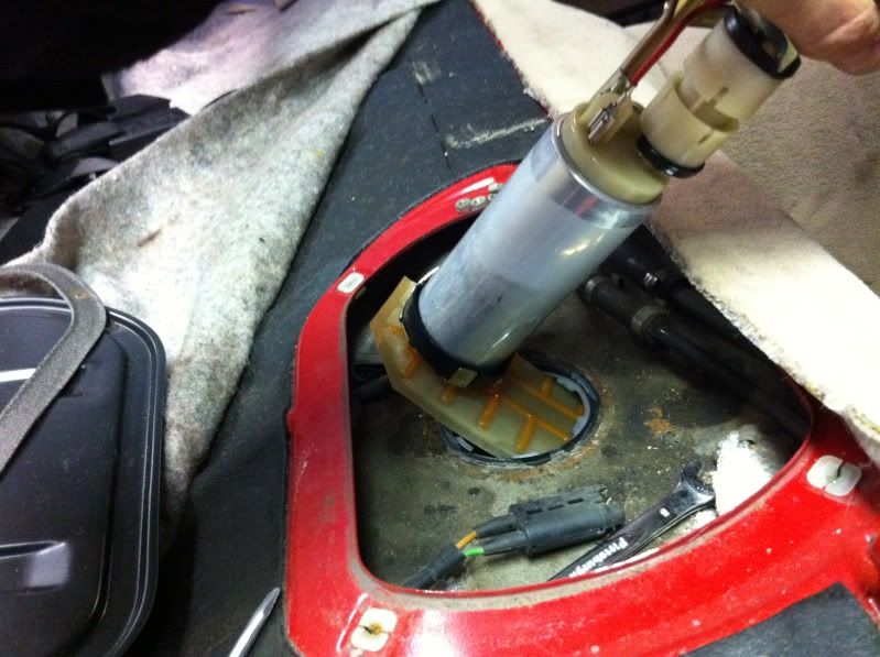

removing the pump is a bit tricky. lift it out to the point you can see the sock, then tilt it so you can get the short section of the sock out of the hole and pull her out. you'll see something like this.
theres your pump!
