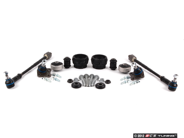

    Currently I'm looking at this Stg 2 refresh kit from ECS for $180. Looks like it covers everything including the upgraded TT control arm bushings. I've heard these can fail. I have access to a good press, so replacing these wouldn't be an issue.

    The LCA rear bushings tend to tear. Don't bother replacing them with stock, go with solid R32/TT bushings.

    The ones included in the fore mentioned kit?

    The items shown in that kit should pretty much cover it all.

    looks like those control arms have the crappy standard control arm bushings.
    I have tt/r32 bushings in two of my cars and love them. my dad loves them in his mk4 2.0, as well.

    What else should I be replacing? I've heard strut bearings/mounts, ball joints, tie rod ends. School me on Mk4 weak points.
    Unless your inner tierods are bad go with their Stage 1 kit. IMHO the balljoints, inner tie rods and outer tie rod ends are NOT the weak points on the mk4 suspension.
    As suggested take a close look at the rear swingarm bushings. If you're getting that far into the suspension it would be a good idea to just replace them. Maybe go with the Cupra R set from boraparts?
