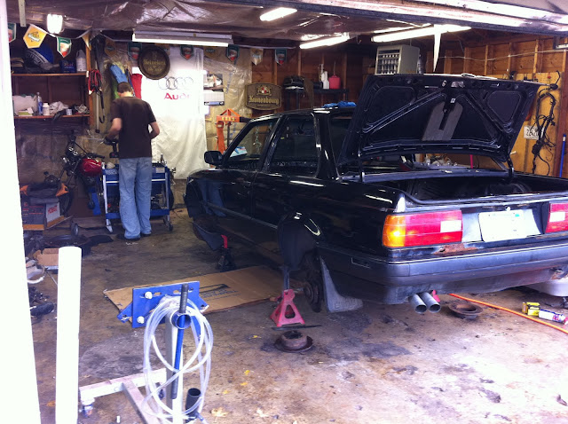

    Over the last few months there has been a group of us talking about getting into chump car. Last friday it became official and the team purchased our car. We got a 90 BMW 325i.

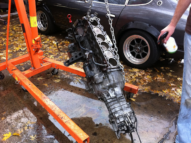

    We just started stripping the car down this weekend so we could get the shell ready for the roll cage and pulled to motor and tranny so we could freshen it up.
    We will be using this thread to document the build progress and race results when we finally enter races.
    Chump Car rules and info

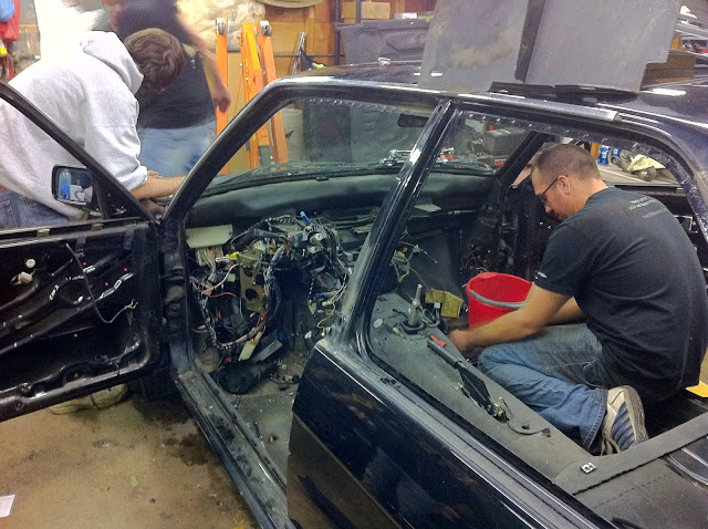

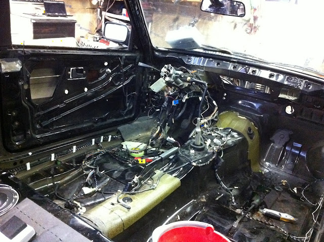

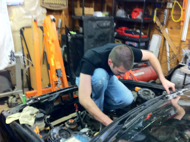

    pulling all the crap out of the car.

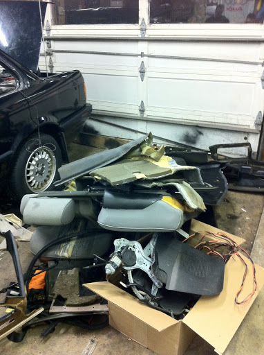

    weight reduction

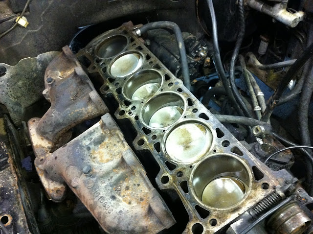

    head is off the engine
    this looks about right
    engine and tranny out
    So far we have only really worked on the car for a few hours. This was the easy part. Now its time for the fun stuff.

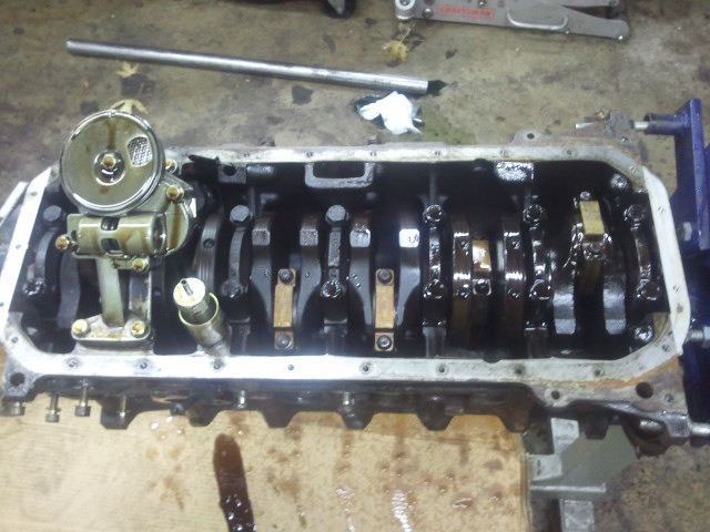

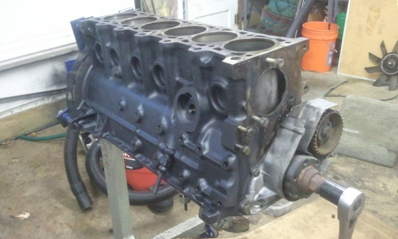

    the bottom end of our M20B25
    piston #1
    sound deadening is being taken out now, much (hopefully) more progress to come this week/weekend.

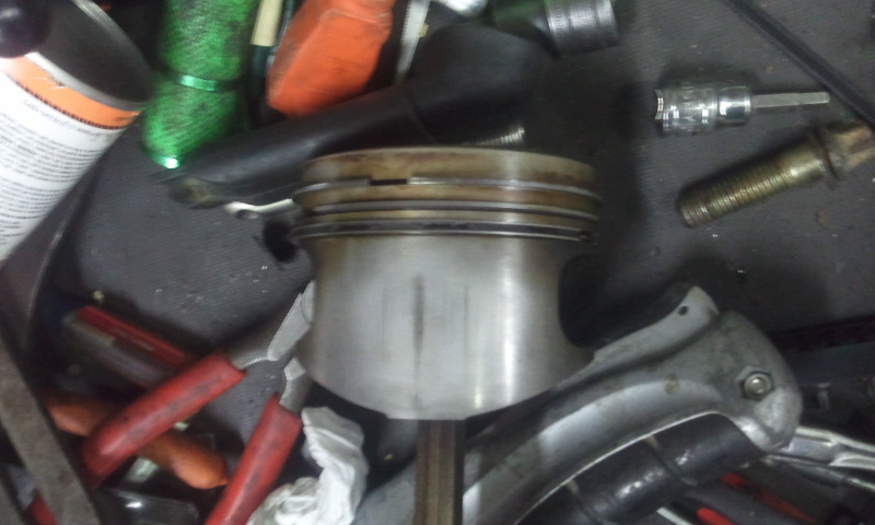

    What was wrong with the motor?

    It broke the timing belt and bent a valve.

    Shouldn't be too bad, I'll assume you guys have another head for it? Did it bugger up the piston?

    tbelt broke on the PO, bent 6 exhaust valves and snapped a rocker.. the rest was in pretty good shape.

    Quote Originally Posted by Champ View Post
    little bit of scaring, but nothing I'd worry about at all. Dan is going to sand the pistons.
    we're getting the head rebuilt (I do have one on the shelves too though, lol)

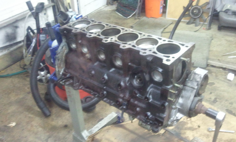

    block sanded, cleaned up

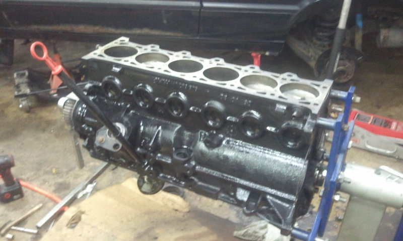

    und painted!
    I like the matte finish.
