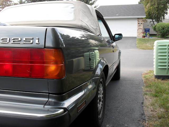

    Before bumper tuck and lowering:

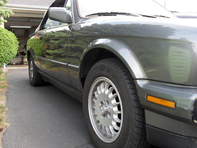

    After:
    Probably drop the front another 1" after I cut the stock perches off and weld up a new one for the sleeve to sit on. The sleeves I got were designed for the E30 and actually slip over the stock cartridge and rest on the top of it. The top of the sleeve just has a small hole for the strut shaft.
