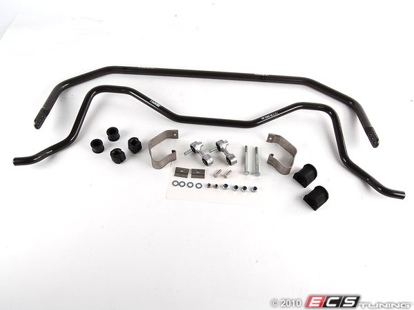

    Thanks for the reply. The kit did not come with the new brackets- which suck. I am going to call H&R tomorrow and see what lame excuse they give me. Pretty positive it's in the right way, not really sure how I could install in the wrong way but yet again I don't know a whole lot
    this is what ECS shows for the kit and this is exactly what I got.

    so after spending some time with H&R on the phone, I have lost faith in this company. The technician(after I sent him a link to the thread) assured me I had the bar in upside down and that the numbers on the bar should be facing towards the bottom. Gathering viewable information, this didn't seem right but I gave it a shot anyways...
    So here is the bar the way the tech wanted me to install it. seems kinda funky.
    mhm
    surely doesn't seem right. some help he was.
    so I flipped the bar back around to the way I had it-
    seems much better, but still the clearance issues on the driver side portion.
    Again- seems like it should go this way.
    compared it with the way my stock bar came out- vahla I had it right.
    can I be an H&R tech, pwease?
    so again...I am stumped. Not sure what to do here
    the tech also said that this bar doesn't require the ''inner clips" and assured me again that his bar will not 'walk' side to side. ha.
    after sitting on the phone for 30 minutes and still no solution to my problem, I'm not sure I would trust that man any farther than I could throw him.
