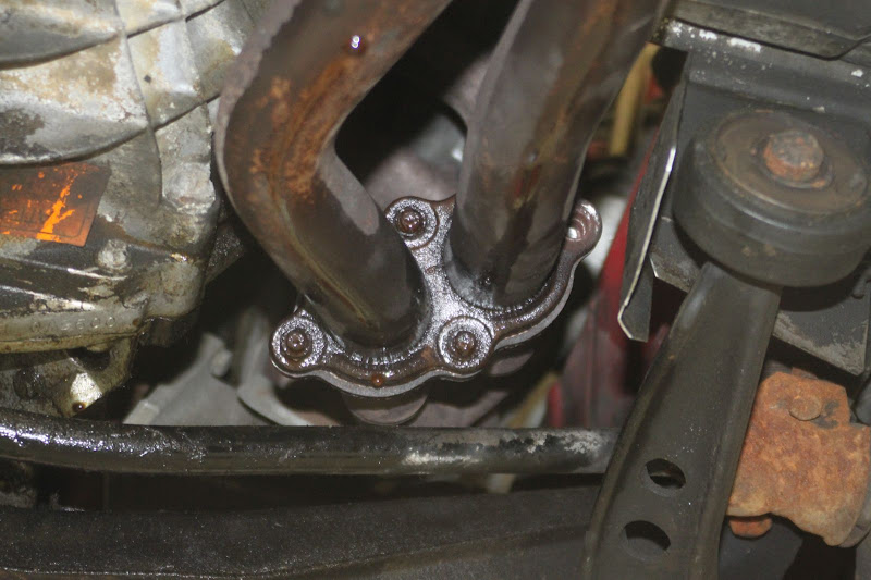

drench your exhaust nuts in PB blaster, get out your impact and 13mm socket.
unplug o2 sensors
drop the exhaust hanger and pull exhaust:

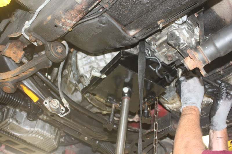

brace the Getrag to pull the rear trans support
remove all 6 guibo bolts.
remove the 14x 13mm bolts and 2x 10mm bolts that hold the heat shields over the drive shaft. after that, locate the two 13mms that hold the center carrier bearing and drop those.... you will need to support the center of the drive shaft after pulling these.
pull this metal brace too.

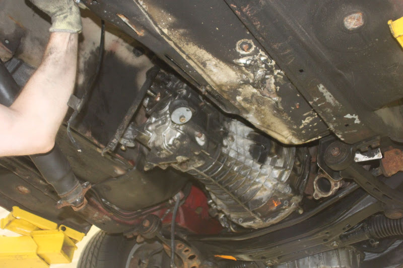

pull the rear trans brace and drop the transmission support so it hangs a bit.

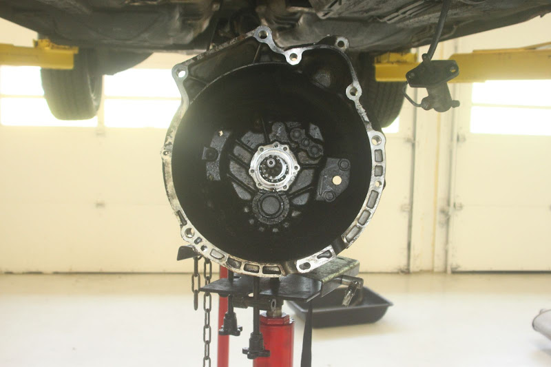

pull the transmission off of the engine.

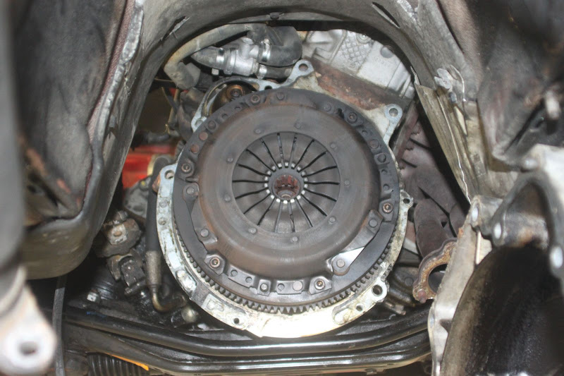

pull the clutch and pressure plate:
install new clutch, flywheel and pressure plate bolts. (torque to 18 lb/ft)

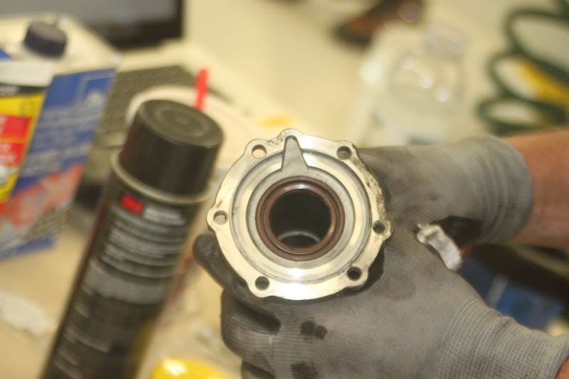

if you elect to do the front transmission seal, do that now.
